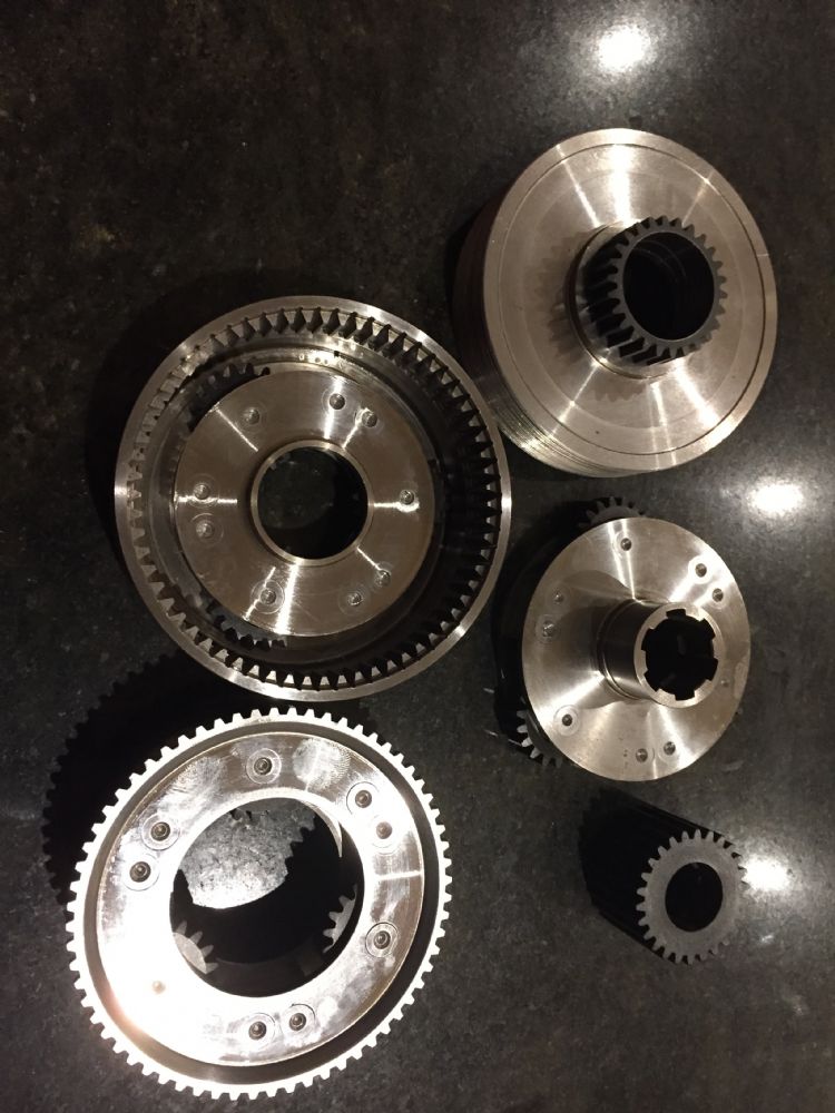

Well... as some may remember, PA 1294 died last April after the preselector gear box seized. Turned out that the oil pump intake disc had been assembled upside down and the box had been starved of oil. Amazingly it lasted 5000km before the 3rd gear planet bearings disintegrated and seized (and was surprisingly quiet right up to the last few miles).
Anyway.... $XXXXX later and a fantastic new close ratio gear set from Tom Dark (we decided not to use what was left of the originals as they were blued with the heat!), and a lot of hours from the boys at Historic and Vintage Restorations Melbourne (especially Matthew Sloan) its all back together. Apart from a full set of bearings the only other thing needed was a new ceramic top gear cone clutch. Lets hope it all holds together!
A very merry triple M christmas to all,
Andrew
