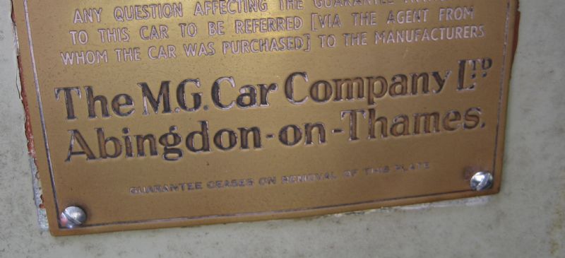

It seems to have been registered as 826UXH at some point, and has the chassis plate shown below on the bulkhead.
6598 Posts
Posted - 14/03/2024 :  17:32:08  Show Profile
The guarantee plate doesn’t look very convincing. The engine number is in the same font as the car number and far too uniform. The engine number would have been hand stamped and not in the same font as the car number. Plus, the addition of the letter J to both car number and engine number seems dodgy, to say the least. Even if the factory did all the things claimed, they wouldn’t surely have changed the car's chassis number in this way.

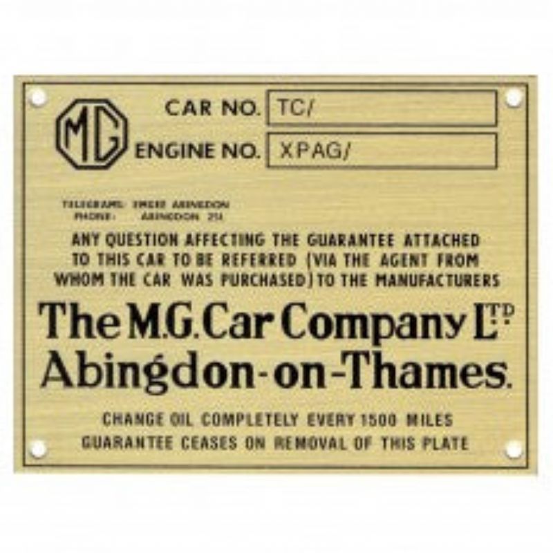

Yes. The fonts are all wrong, as is the layout and the two monstrous dots under the Ltd. It would seem to be a butchered version of this particularly nasty repro

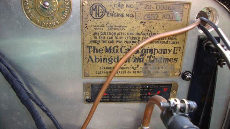

There is a picture of D0301 in the MG D Group list of 'Survivors'.
The very rare and strangely recent looking pre war colour photograph must have been taken prior to 1939 when the car still had a D-type body. Well worth a look.
DK6780
429 Posts
Posted - 15/03/2024 :  11:20:27  Show Profile

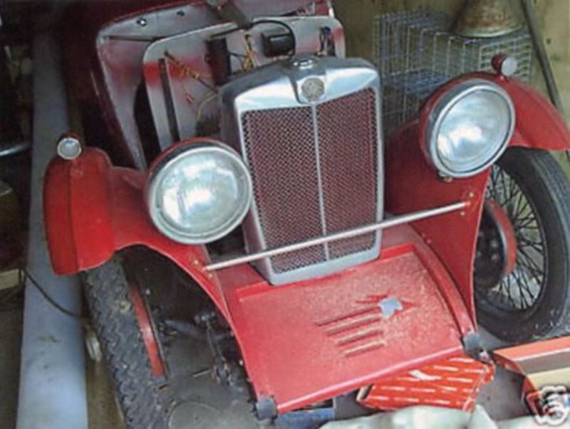

This one? I too would place the photo as much more modern, but apart from the front wings am not confident about which body is fitted.

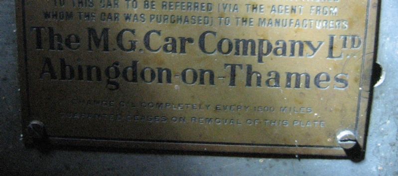

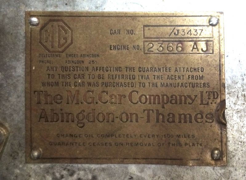

723 Posts
Posted - 15/03/2024 :  19:18:24  Show Profile
Sam- what is your top photo from of the plate without the change oil line?
