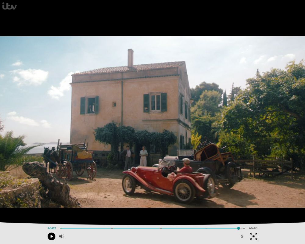

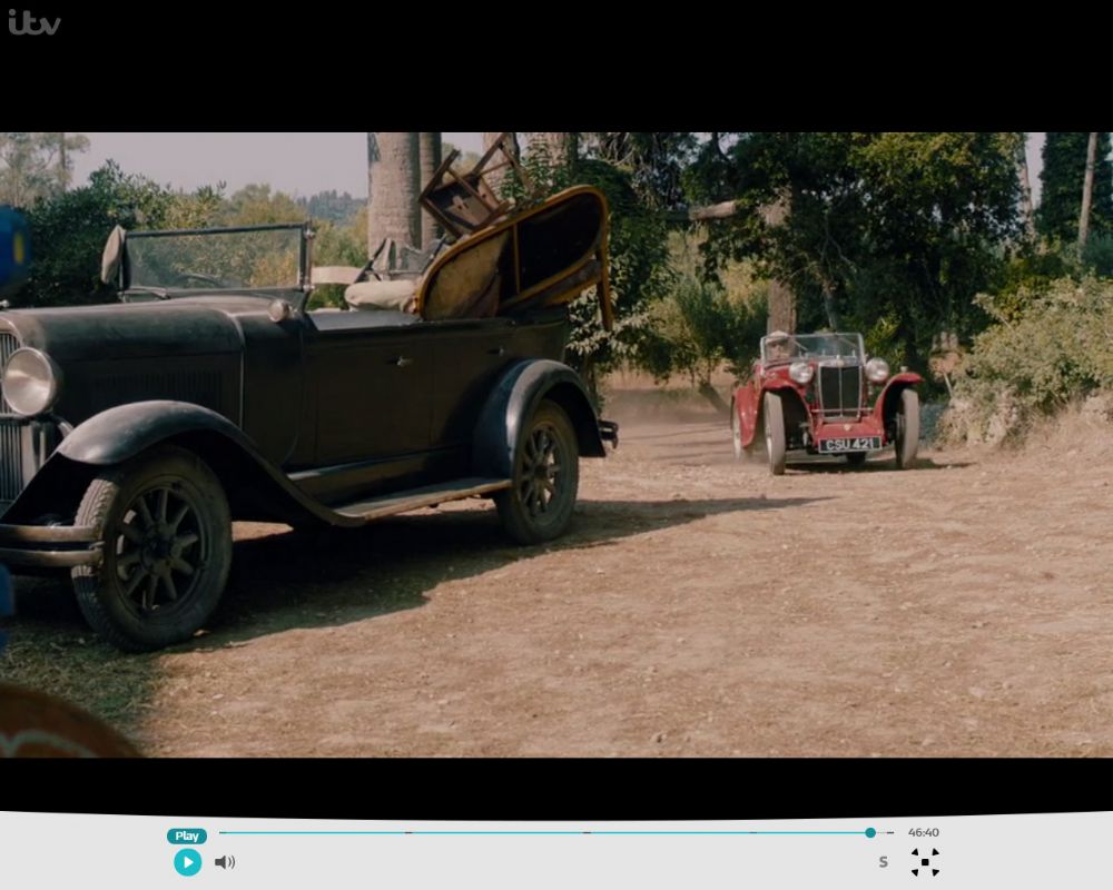

Now here's a thing: at the very end of this evening's episode of the Durrells there appeared a red PA, registration CSU 421. Not bad to find a British registration on Corfu, although I believe part of the series was shot in Jersey .

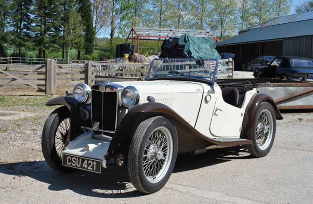

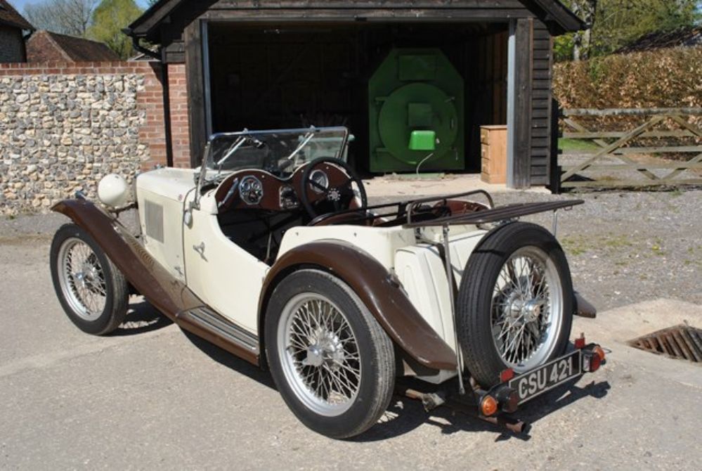

But I'm not sure what to make of this, because that reg belongs to PA0870, which by all accounts must have changed its appearance for artistic purposes, because the records of 2 years ago show that it white with brown swept wings! Oh, and it has an A-series engine...
Might have been repainted? Might be a different car?
On the other hand it/they have hydraulic brakes!
In recent times the car was sold by an owner in Send (Surrey) to another in Chandlers Ford (Hants) The last we know of this car is that it failed to achieve the reserve in a June 2015 Brooklands auction http://www.i-bidder.com/en-gb/auction-catalogues/historics-at-brooklands/catalogue-id-ibhi10009/lot-9d8a26b9-8e1a-4887-8039-a4a500c46be4 .
There was a rumour that the car might have gone to Italy, but from what we are told that does not seem to be correct....

The red car looks to have the same badge bar, rear lights and centre laced wheels.
Registered with the DVLA as 'SORN in place' and also colour is listed as 'cream' so perhaps currently abroad (and re-painted) but with a SORN in place to keep the number (which looks to be an age related one rather than its original one). It was apparently originally a four-seater and a University Motors demonstrator.

I did notice on the TV that the car still appears to have brown trim.

As regards the hydraulics, I notice both red and chocolate & cream have 8 inch, or could they be 9 inch drums? Also both red & white have appropriately coloured headlamp back shells. Both have flat topped aero screens, but the luggage rack & MGCC badge have gone.
Looking at the auction details, it seems that the gearbox is also "A" series which might make it a more suitable candidate for driving by an unschooled actor?

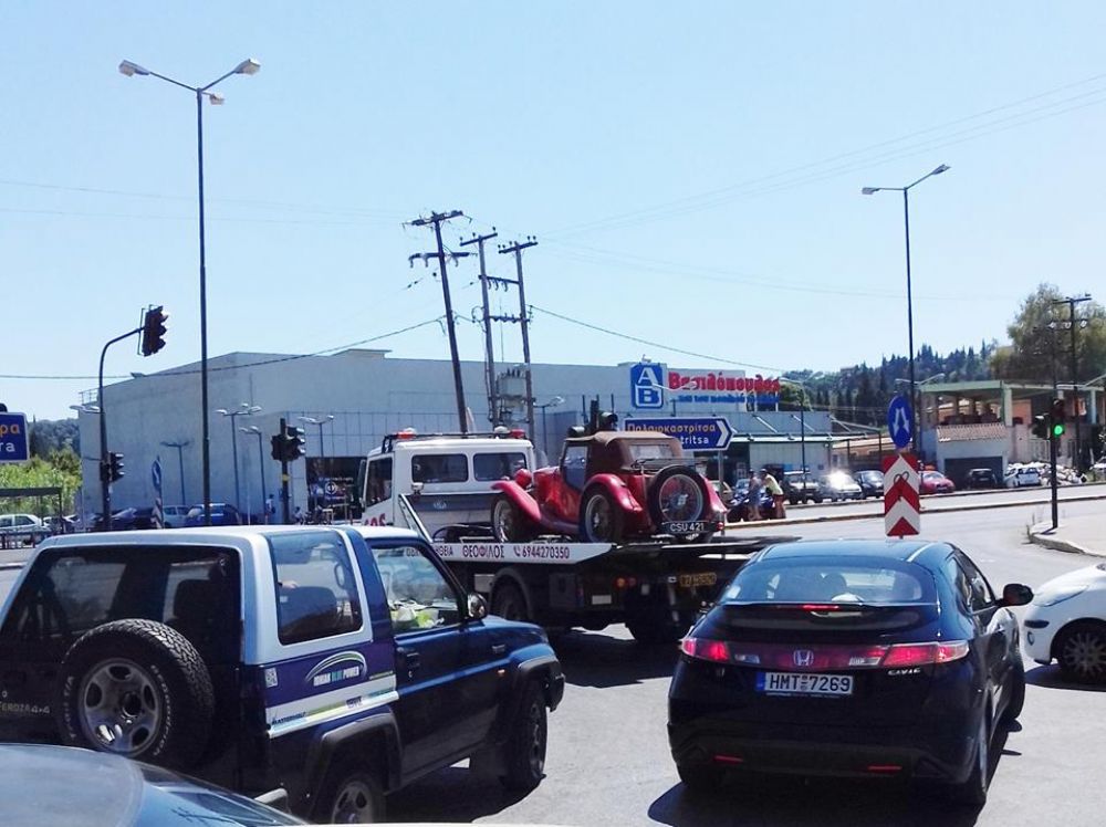

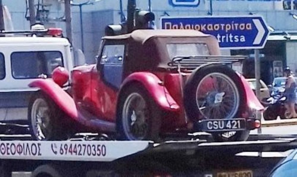

According to Mark Hyder-Smith who I think resides on Corfu:
I saw your posts from April about the above car appearing in “The Durrells” and you may appreciate an update on its life.
As you will see from the attached Facebook link the car is still on the island of Corfu (the next series is in production). I can’t tell you where it’s come from but appears to be alive a well in the sun here in Corfu. As with the other car used in “The Durrells” it’s transported around the island on the flat bed as the local roads can be a little dodgy at times.
https://www.facebook.com/photo.php?fbid=450205068668634&set=pcb.1419626484780888&type=3
