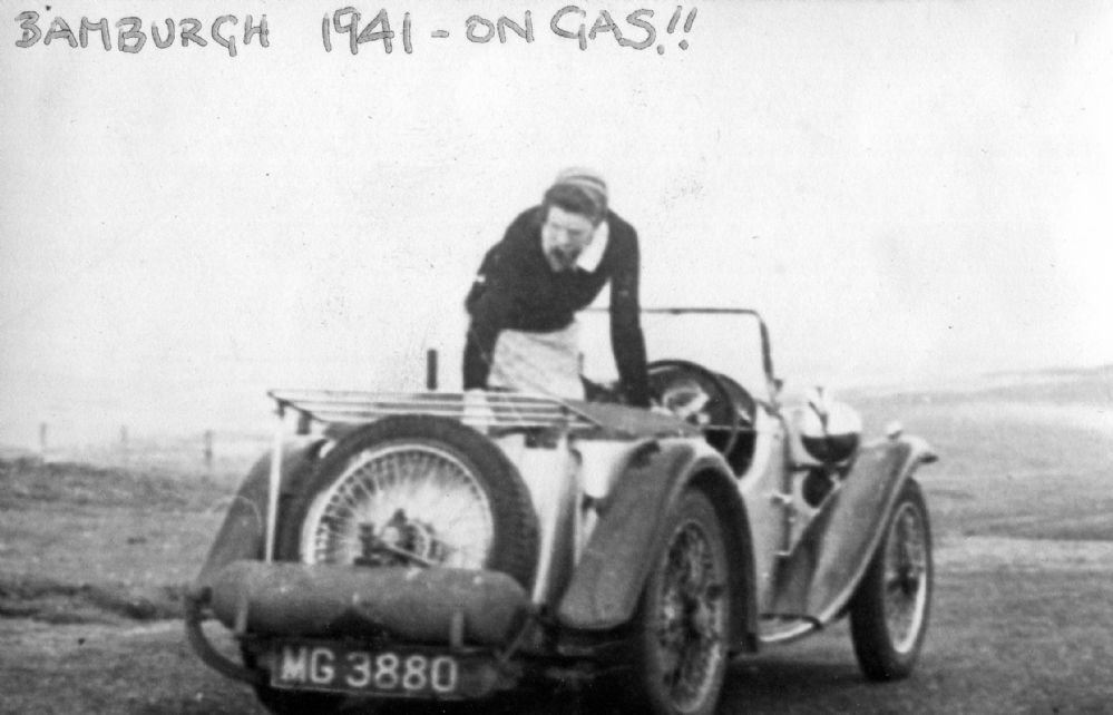

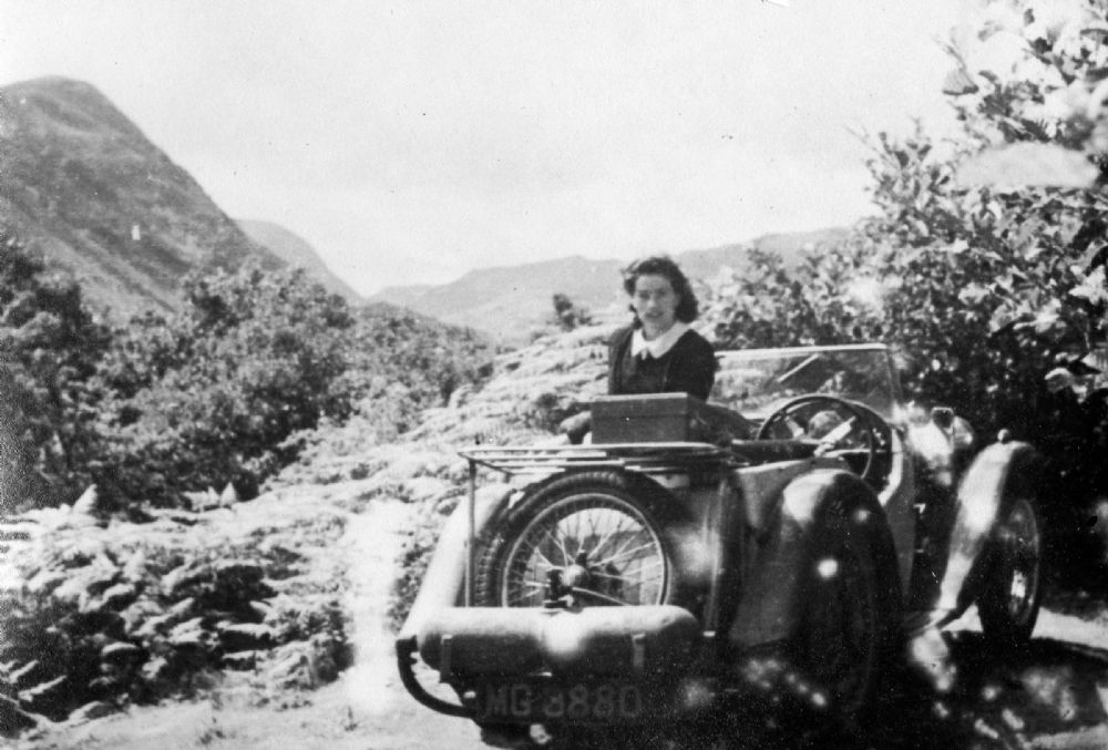

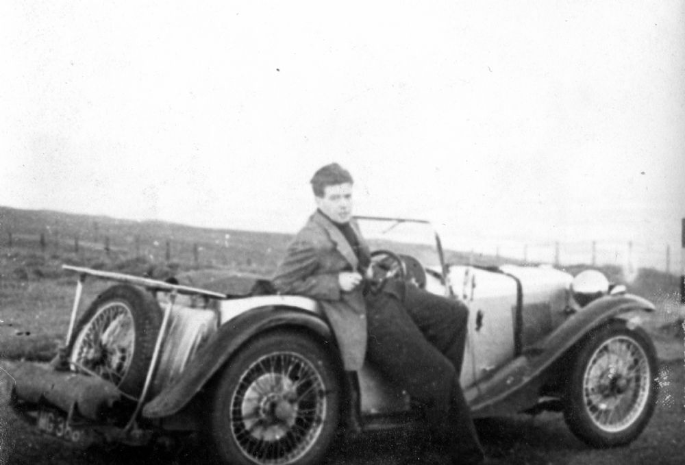

As some may know I would dearly love to find MG3880 form a previous posting however the posting in General Information about "All electric Midget" prompted me to dig out these photos with the hope somebody can explain how my father made his gas conversion work.
My father in 1941 having rebuilt P1815 needed to supplement his meagre petrol ration to continue his courtship. He converted the M.G. to run on town gas from a cylinder strapped to the chassis behind the spare wheel. I do remember him telling me the car started on petrol and immediately gas was turned on and petrol off by a pair of taps. The gas being injected into the carburettors by fine pipes, all seems quite lethal but it worked. I do understand many cars ran on town gas from bags on the roof by simple gravity, what I wish I had asked father was how he compressed the gas into the cylinder.

20 or so years ago, I converted a Rover V8 powered Landrover 110 to dual fuel: LPG & Petrol. It proved a successful conversion saving me 10p per mile over 100,000 miles. LPG is quite handy as it can be stored as a liquid at a comparatively low pressure; it is a low carbon fuel, burns with considerably reduced emissions over either petrol or diesel and has an octane rating of around 120.
The system was basic; a vaporising regulator, much like a diver's demand valve, fed low pressure gas through a simple vacuum controlled regulating device to holes in a venturi, upstream of the carburettors. The Stromberg carbs themselves were effectively disabled by cutting off the petrol and automatically raising the dash-pot pistons leaving them only to perform the butterfly throttle function.
I believe in the case of Coal Gas, it was usual to store it at a low pressure; hence the great big bags seen in photo's on top of vehicles. I can't see how one could get much coal gas into the cylinder on the back of the P in the photo, even under pressure as it does not liquefy conveniently like LPG. I suspect it was probably filled at the mains pressure which could have been augmented by the inclusion of an externally accessible inflatable tube or balloon inside the cylinder to compensate for the pressure drop as the cylinder emptied.
