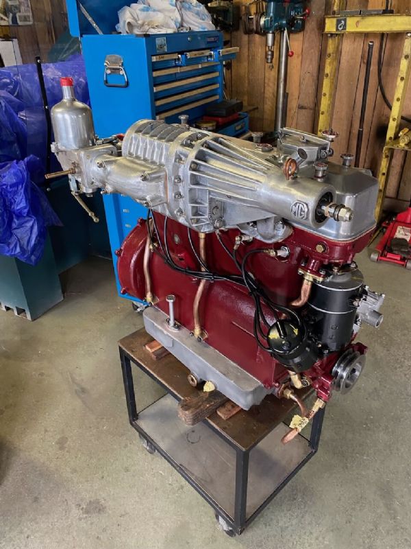

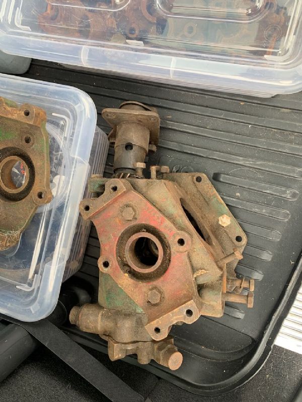

I have just rebuilt my N type engine which to my knowledge has only been rebuilt once before. While the block had been repainted bright red the engine mount, flywheel housing, bell housing and front engine housing were all still in the original factory paint. The photo below shows the original colour.
I also have a front engine housing for a K type that I am about to send to a friend. It is still in its original paint and is green (as are other parts of that engine).

Andrew,
When I bought my PA in 1966 there were quite large areas of the gearbox, (including the alloy parts which have often been discussed in the past) bearing Post Office Red or something very similar. The car was definitely at the student banger stage then & I would have thought it unlikely that anyone had troubled to re paint the box in the previous 30 years. It is the car's original box and I doubt at that stage had ever been removed.
What I think might well be the case is that paint batches differed from one another far more in the '30s that they do today and so the next batch of engines may easily have received a different shade from the last thus confusing all of the OP.

Interestingly the engine mount in my photo appears to be pillbox red.... so I would appear that as you suggest dave, there were several colours.

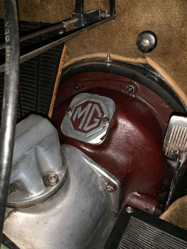

The bell housing on my P type is the same as on my NA.
The dark red does look good though....

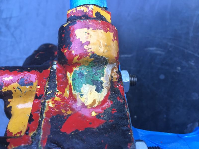

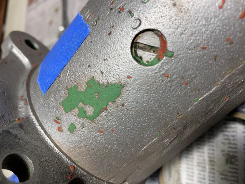

Just to add needless confusion. After bead blasting through black, red and yellow layers of paint it appears the bottom layer (factory) of my PA engine was a sort of apple green.

Green is the same color my father-in-law found on our PA when he was restoring it, but was advised MG Maroon was the correct color, so that is what he painted it and what it will remain.

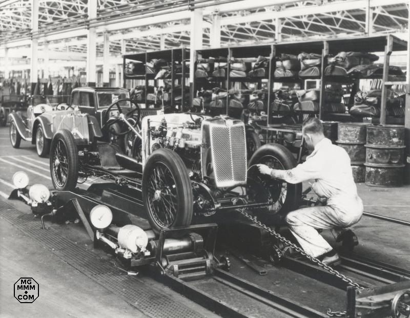

I really shouldn’t have to drag out this photo yet again to clarify that, despite Mike Allison's recollection, the front apron and tank were painted body colour as evidenced, for the tank at least, by what looks to be a J2, in duotone paint in the background.

Bruce, I have no idea how to update the table but as to the theory of the body being painted in Coventry and the other parts in Abingdon, I can see some sort of logic there. The idea falls down though on two fronts as I see it.
1) I doubt very much that the bonnet would go to Coventry to be painted, ergo Abingdon had to mix the pale colour for that. It must be said that having a pale body and a dark bonnet would be quite bizarre.
2) How were mono-tone cars treated? I can only assume that again that one shade was successfully mixed in both Abingdon and Coventry.
I prefer to believe in the evidence in many photos, at least one of which was published in Mike's book, The Magic of MG and two of which Simon has posted above.
