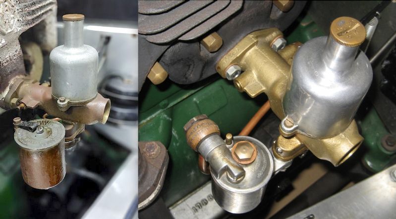

I've just dipped my toes into the MMM world and purchased an M Type. Can anyone advise me what model of SU carb this is, and where in the UK can I purchase a service kit, float needle, jet, and carb needle?

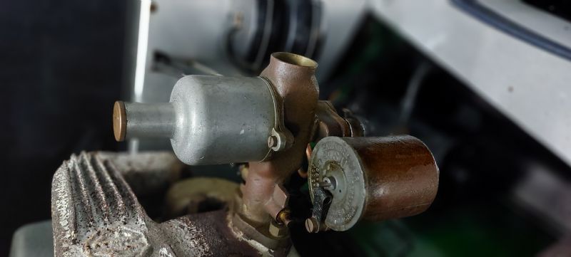

Thanks Nigel, I'll give SU a call. I'm not sure what I have here, the carb kit looks right for the car, but the float chamber is something else. The car is 1933, but this carb and float bowl look older

You certainly seem to have an original M-type carburettor including the float chamber which is commonly seen replaced with a later equivalent.

Excellent information Sam, thank you for the confirmation. The issue is the float needle is not seating in the base of the bowl, so fuel flows freely, all the time...not ideal. I can see the needle is worn and they say not to attempt to correct this??? I'm hoping SU/Burlen can come up with a solution.

Royston, I have had the same issue with my M Type carb and Burlen supplied me with a new style float valve that was in a nylon carrier and included, if I remember rightly, a light weight spring to help it seal. I could not get this to work correctly and I assumed/deduced it was probably because the petrol pressure was purely gravity and not from a pump. I resorted to carefully regrinding the old stlye pointed steel needles mating them with the brass seat until I had a good seal again. I am still using this 12 years later with no problems. If you look at your needle and seat you will probably see signs of a ring where the the seal is made. You need to regrind this with fine grinding paste and finally cutting oil until it has gone and then check the seal with petrol.

Thanks Royston, though I have failed to answer the question as to which model of SU carb this is.
The alloy the old flat topped float chambers were made from ages badly and they prove increasingly troublesome. It might be easier to use a later float chamber and I am sure Burlen will advise about this.

Thank you Keith, sounds positive, so I'll give that a bash in the first instance. Failing that I'll go down the route Sam has suggested. Nothing to lose. krgds Royston

Interesting that you have that carb on such a late car - I'd expect it to be the other type. There's a lot written and said that the earlier float chambers are unreliable but my experience (on other car makes) is that they work well. But on MGs I only have the later type so can't comment directly. If you want to swap to one of the later float chambers I'd be happy to oblige.

On 2M1281, I had the later style float bowl, but through a trade, was able to acquire the flat-top bowl. I have since sold the car, but to the best of my knowledge, the flat-top bowl is still functioning. well. It simply looks the part.
