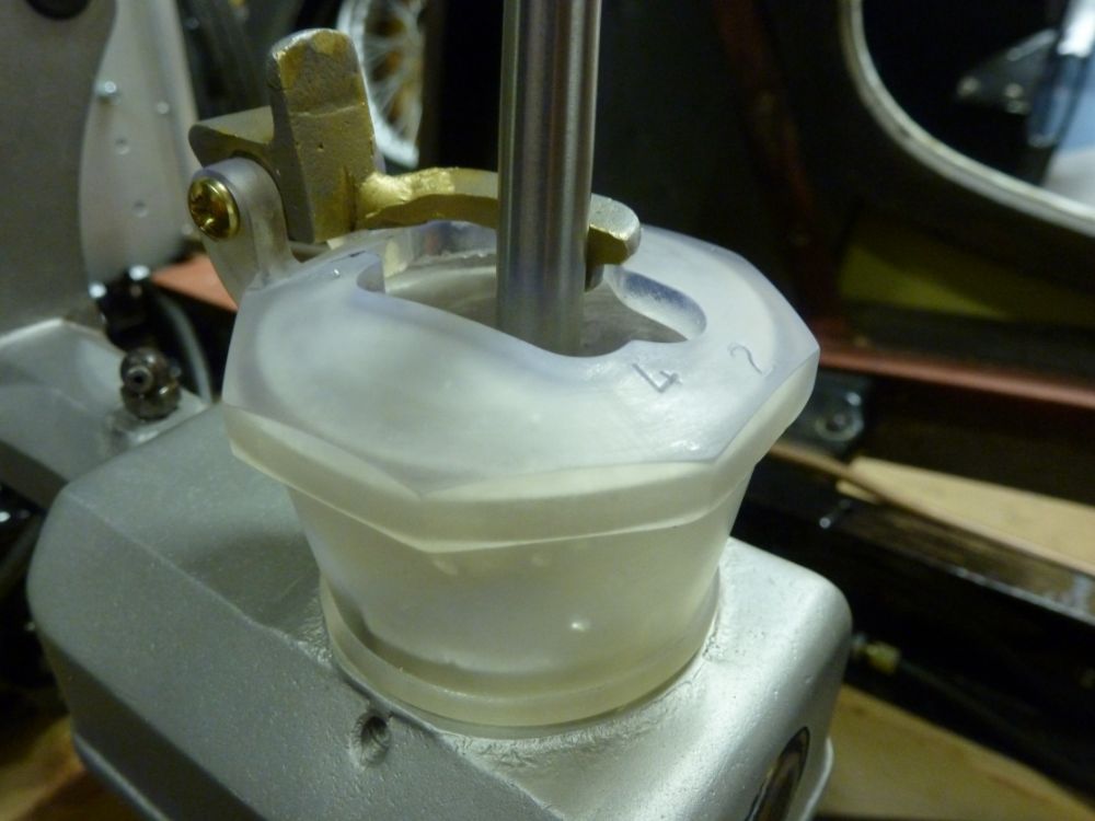

I thought I would share a little project I have been working on.
Having failed to find another undamaged gearstick turret for my P-Type, or get the one I have repaired, I have been trying a different approach.
The mechanical engineer at work has kindly created me a 3D CAD model of the turret and we have 3D printed it.
I'm now on the second version, and there are a few more tweaks needed to it. The photos are of the printed turret removed from the support structure that the printing process created, together with it painted.
My plan, at least initially, is to machine in a small metal bush in the bottom where the gearstick ball sits and use it.
I know it is not perfect, fragile and a bit brittle in the plastic it has currently been printed in, but it is still better than the one I have.
The bonus is that I have the 3D CAD model and once I'm happy with it I will get a cost for 3D printing in aluminium. That should be interesting!

Nice jobPaul! This is also a part I need. Saved by a new gear lever last time however so much wear around the ball that will start to pop out of in 2nd gear again sooner or later. I'm working on some 3-part casting resin moulds with insert suitable for investment casting as I believe ideal (fine detail and accuracy) for for the MMM dashboard grab handle, SF24 trafficator arm, and knock-off wheel hammer head let the forum know how I get on. This method would suit the remote gear tower too reckon. With removable mould inserts, allows for internal shapes. Yes, my reverse gate also broke (a second time after brazing), made one from solid brass. Donald PB0759 |

Further thoughts. Paul, most interested in the feasibility and price to 3D print in aluminium, will watch out for news. Interested in how were made originally, anyone know? To investment cast, my thinking is to make in 2 halves each with a 2 part die, then weld and hand finish the wax forms together, before casting. Bit like making a bronze sculpture with internal 3D detail. As far as I am aware yet to be successfully reproduced, I suspect quite challenging. Donald PB0759

If you are going to use as a mould for casting, you need to oversize to allow for shrinkage (2% for steel and 1.5% for aluminium alloys), and unless it is for investment (lost wax) casting, to work out the split lines to remove from a sand mould.

Well done Paul I think this is a part that many people wish was available, me for one. As an alternative to 3D printing Aluminium, it looks possible to 3D print wax and use this for investment casting. This would allow the whole part to be produced as one piece of wax.

A further bit of tweaking has been done - a slight re-profile of the gear stick opening and the internal bosses for the mounting bolts.
I still need to find a better number font that is the right shape and boldness.
I had thought about the possibility of printing a mould to allow casting to occur. We will see..
I will try the aluminium printing route first and see where that goes.
As with most things, the more that are made, the cheaper each individual item becomes. Usually.
Paul. |

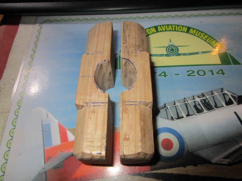

Ian, yes, to avoid extra machining, would need to be made in right and left male/female with inserts each for wax moulds. One insert for the reverse lever tab, and one for the underside ball joint. The two wax halves would need to be joined and cleaned up ready for ceramic coating then casting. Attached photo of my gear lever turret, with hand made reversing gate made from solid. Ball joint wearing and saved by a new gear lever, was popping out and jamming in second before that. Believe the J type is the same without the reverses gate tabs. I think after my current investment casting projects, may be ready for the gear lever turret, a really difficult one, next year if there is still a need for a version to be made. Enjoy hand making the moulding blocks which I carve by hand in wood, same way I suspect as the originals complete with minor imperfections. Attached the blocks I am making for the lead knock-off hammer head. The handle will be an insert for investment casting. Found someone set up to cast lead. Donald PB0759
