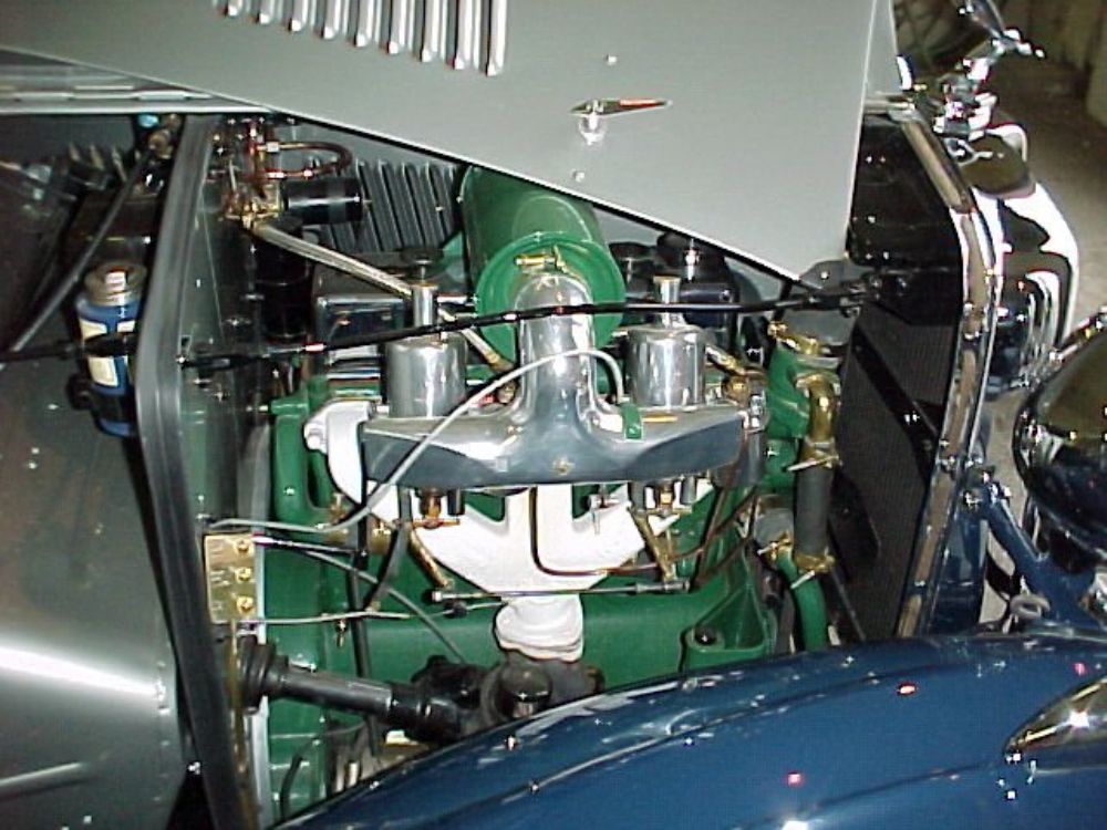

DVLA says it is 1172cc which means that it most likely has a Ford engine. A good suggestion as an alternative though.
Orstin
673 Posts
Posted - 20/10/2017 :  11:37:09  Show Profile
I've been under the bonnet and I don't think it's a Ford engine...
So many dynamos
2249 Posts
Posted - 20/10/2017 :  11:45:12  Show Profile
Looks like the DVLA is out of date!
Orstin
673 Posts
Posted - 20/10/2017 :  13:11:18  Show Profile
Indeed!!
So many dynamos
Bruce Sutherland
1608 Posts
Posted - 20/10/2017 :  13:13:21  Show Profile
And from Hugh's photo, it's been fitted with a heater!!. No cold feet here then
Mikeenty
209 Posts
Posted - 20/10/2017 :  20:36:05  Show Profile
Looks like a Triumph/Standard engine. Spitfire? MG Exhaust manifold so Midget 1500?

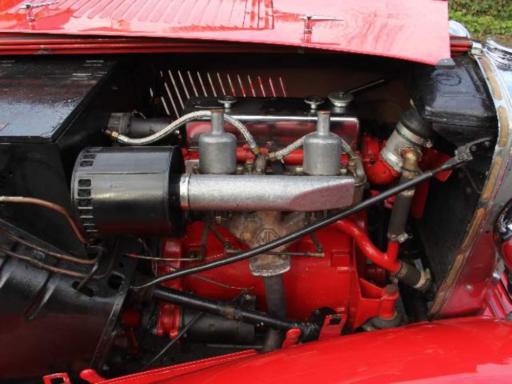

Posted - 21/10/2017 :  08:03:57  Show Profile
As I say, I'm told it's an MG VA engine or equivalent.. Comparisons with images of a VA engine on the web would seem to support that..
So many dynamos
3359 Posts
Posted - 21/10/2017 :  16:27:56  Show Profile
I'm not familiar with a VA engine, but the water inlet and outlet to the head are the same as a TA. But 1172cc is no where near the capacity of a VA at 1549cc. But it also isn't the same as a TA at 1292.

Orstin
673 Posts
Posted - 21/10/2017 :  22:07:38  Show Profile
Blimey, how much evidence do you want?
MG VA engine ...
So many dynamos
3359 Posts
Posted - 22/10/2017 :  04:23:50  Show Profile
I don't mean to prolong this diversion from the original question, but Hugh, compare the water outlet from the front of the head to that in the subject car. Notice that the thermostat housings are very different. The VA has the thermostat housing coming vertically directly off the head. The TA engine has it coming off to the side from the body of the water pump.

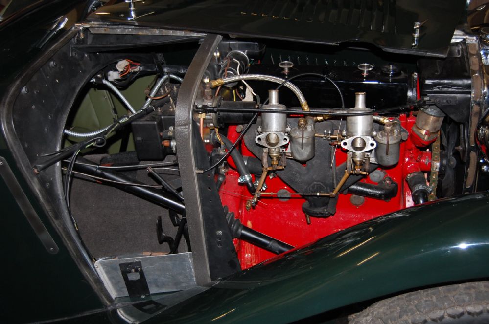

Orstin
673 Posts
Posted - 22/10/2017 :  08:49:27  Show Profile
Well, this is what a TA engine looks like. Clearly very similar...
But like you say, this is becoming a distraction from the original post....
