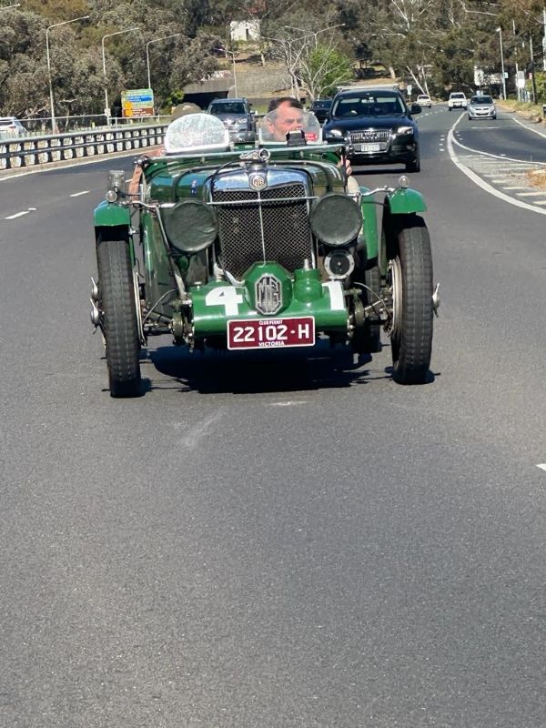

Great pictures, thanks. I am puzzled by the odd positioning of the front brake cables on the K3.

Might they be hydraulics, Chris?

Apparently the car has had hydraulic brakes for many years.

I thought that but it’s an unusual position for the hydraulic pipe to be placed. I can only assume it had to be necessary!

It’s a hose, not a pipe and apparently having hydraulic cylinders top and bottom makes it easier to bleed. (It’s a twin leading shoe system.)

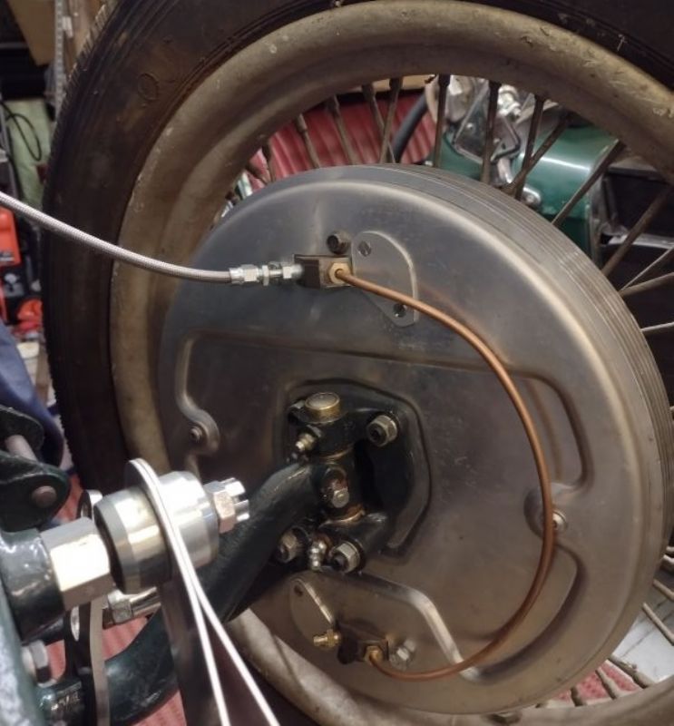

Interesting revelations on the hydraulic hose/pipe routing. I have a two leading shoe set up with cylinders top and bottom and have been mulling over the possible bleed drawbacks with the nipple on the bottom one.
This could be avoided by making the hose connection to the bottom and sighting the nipple on the top cylinder but with the odd hose/pipe routing that the illustrated K3 has.
I was encouraged by spotting a car in the Paddock at Mallory a couple of weeks ago which had the arrangement as shown in my photo and I thus concluded that this set up must be usable.
The top hose/pipe connection could be cracked to aid bleeding or if all else fails then the connections can be switched. I have yet to commission and bleed the system.

I'm amazed that such a long bridging pipe is unsupported. There is a golden opportunity to do so at the point where the cable stop would have been fitted.
Also the photo has been set "right side up" while I was typing. I suppose it was obvious anyway but that really is not the ideal set-up for bleeding as Nigel has queried. Far better to have the nipple at the highest point. Hence probably the "strange" hose arrangement on K3002.

That is already on my "Check off list"; the ultimate Chekhov short story?
