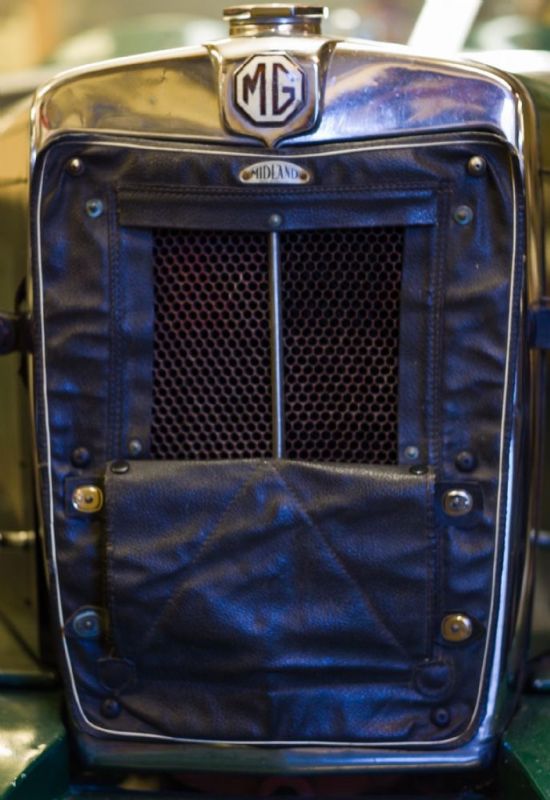

A quick update ... the first of these are now ready and we are taking orders
We will be fitting 6mm I.D. eyelets and positioning them approximately as per the original “Midland” radiator muff illustrated, unless requested to do otherwise.
Possibly the original design was intended to fit cars with the period honeycomb radiator without a grille, and fixings were simple through or hook bolts with a securing nut and a thumbscrew to hold the muff.
Things are a bit more complicated these days with the addition of false honeycomb and modern cores behind aluminium mesh or slatted grilles, all of which makes a universal one-fits-all fixing method nigh-on impossible. There are some older grille type fixings out there such as the ‘Kingsbury Wintershields’ type, but these are hard to come by; maybe keep an eye out at autojumbles!
Commissioning a small batches of fixings as per original or to suit all current permutations is really not viable.
With this in mind, we will be supplying the muffs with a flexible fixing system that will hopefully cater for most variations, and of the type commonly used these days to attach aftermarket cooling fans to radiators; a 200mm long slim ‘toothed’ rod, retaining clips and pads as seen here:
https://www.demon-tweeks.com/uk/pitking-products-universal-fan-fitting-kit-pkpfkp01/
Although not ideal and not very ‘period’, hopefully these should satisfy most, at least in the short term, and with a little care may be reused the following season.
Most owners of Triple-Ms are resourceful and practical types and may wish to adapt or replace with alternative fixings to suit their particular radiator/grille combo.
If you are happy to proceed on this basis then please let me know and we can take your order, as we will be ready to post out the first few during the first couple of weeks of January.
Many thanks,
(photo: Coracle/Nigel B)

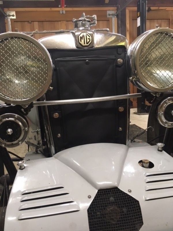

Posted - 04/01/2025 :  12:03:56  Show Profile
and fitted, perfectly!
