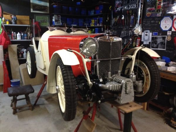

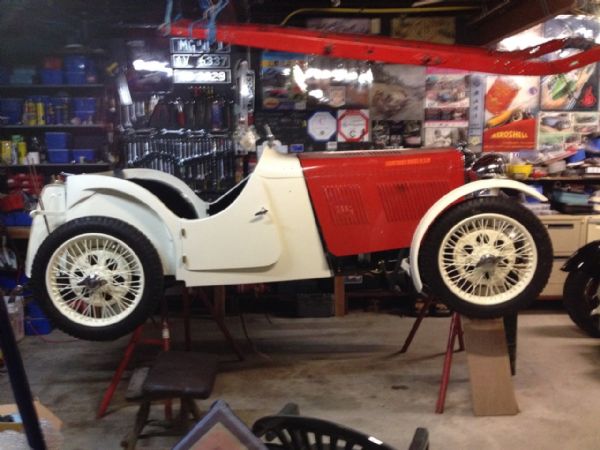

Please find attached some photos of J3763 competing in Australia where it is often referred to as a J4 in the newspaper reports. The larger brakes, outside exhaust, ENV cross tube box and larger supercharger contributed to this description.
The additional photos show where J3763 is today. Historic and Vintage Services in Melbourne repaired and riveted the original chassis and cut doors into the body tub. Not that they are of any use for the passenger.
With the help of some enthusiastic MG friends the car is being rebuilt as it was in the 1930's including to the dismay of some the quite distinctive supercharger cowl.
Thank you to all who have provided information to the forum on J3763.

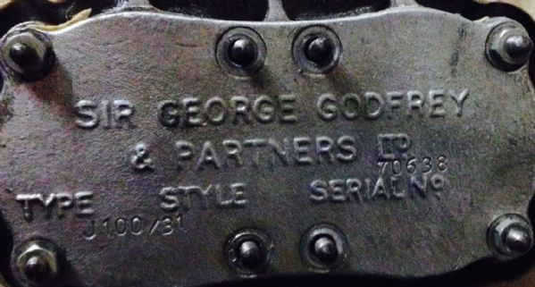

From photos taken of the car running in the 1930's and 40's we have decided to use a SIR (not a term used often in Australia unless your our Prime Minster) George Godfrey J100 Sc.
It is expected to run at 8-10lb, which should add more bang hopefully too suck, squeeze, bang, blow.
If it does not work, it will do doubt end in tears and recriminations with my friend Norm Goodall over whether it was driver error or his ability to rebuild MMM engines and I know who will be the loser of this arguement.
Attached few more photos from the 1930's, 1940's and one of the Sc cover.
best wishes
ross kelly
Posted - 13/04/2015 :  22:52:50  Show Profile
Hi Koke - I look forward to seeing a photo of your lady mascot, it probably looks more suitable on a Rolls rad?
Ross - I would anticipate a higher boost than 8 to 10 lbs from a J100 fitted to a 4 cylinder engine? I have a J100 fitted to my L2, it is run at slightly over engine speed and gives up to 12 lbs boost. The Oliver Richardson rebuilt engine gives an amazing and very smooth performance.

George, Oliver agrees with you that we should anticipate a higher boost and given advice on how to manage it. We should know in the next two months how it goes.
